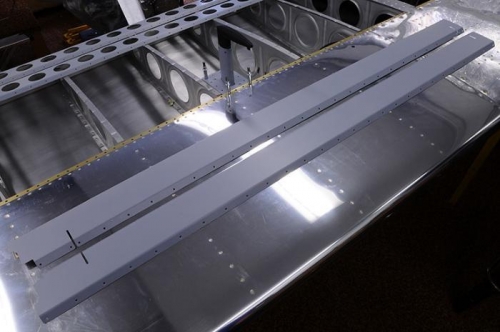

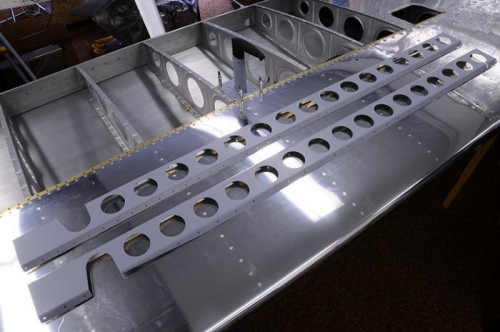

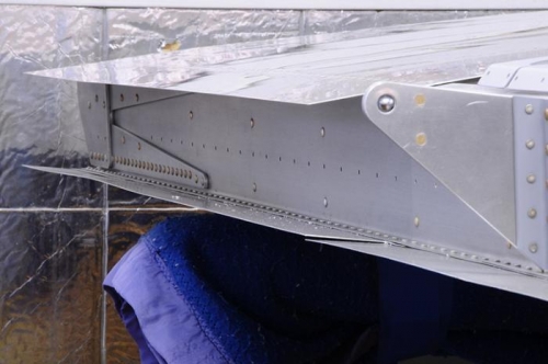

There are two supports that are riveted between the rear spar and top/bottom skins to provide a support for the flap installation and a gap seal for the aileron installation. The pieces are pre-cut, pre-bent, and pre-drilled. I primed the inside facing side of each and then riveted them into place on both the left and right wings. Took a while, but the installation came out perfect.
Flap Supports Primed & Ready For Installation
Aileron Gaps Seals Ready For Installation
Left Rear Spar Flap Mount Area
