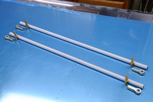

Brief Description:  Aileron Push Rods - Part 1

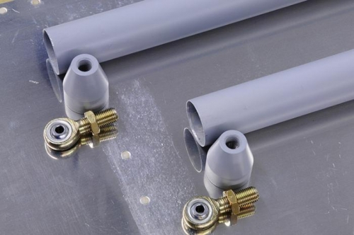

The aileron push rods were pretty straight forward to assemble. The hardest part was probably getting the primer down inside of the tube completely. I ended up using a wad of paper towel on a long piece of 1/4" tubing, saturating the wad then shoving it through the tube. Worked pretty well, I guess. Setting the rivets on a round surface was also kind of a challenge. All in all, though, they came out very nice.
Bell Crank To Aileron Push Rods - Cut & Ready For Assembly

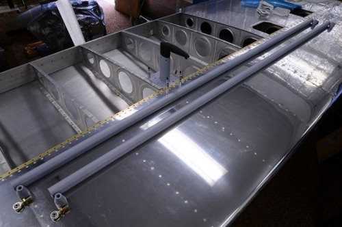

Control Stick to Bell Crank Push Rods - Cut & Ready For Assembly
