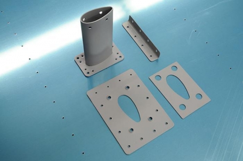

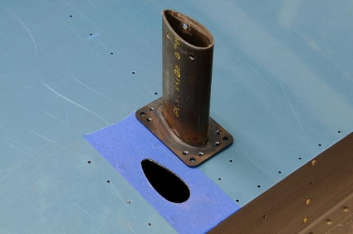

Hole Cut In Bottom Skin
Various Pieces Fabbed & Primed
