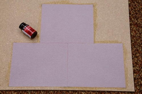

Super Flat Sanding Surface

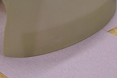

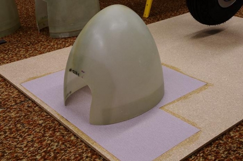

Sanding Front Part Flat
