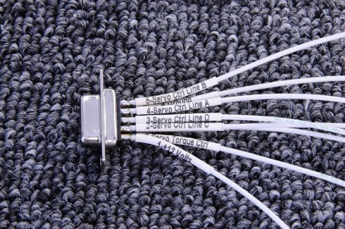

Pitch Servo DB9 Connector

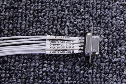

Roll Servo DB9 Connector

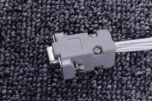

Servo DB9 w/ Shell
Servo DB9 w/ Shell
