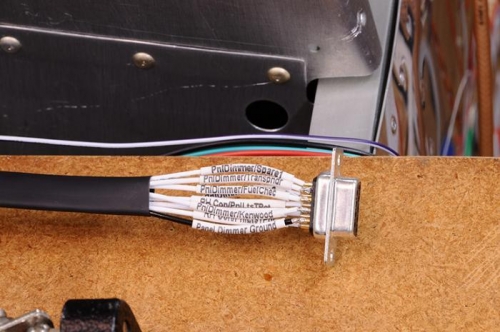

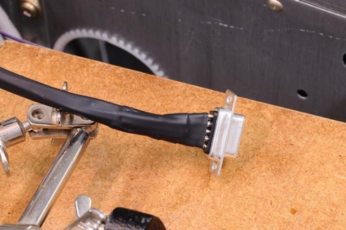

Cabin Dimmer Connector
Instrument Panel Dimmer Connector
Connector Ready For Housing
