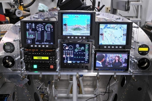

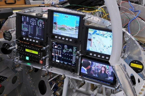

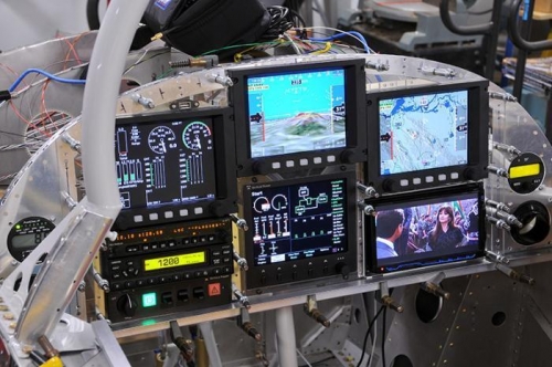

Brief Description:  Instrument Panel Power Up! All Glass! - Part 1
I interconnected all of the major instrument panel devices tonight to the VP-200 power system and powered everything up. I also wired up the GPS and EIS4000 (engine monitor) RS232 serial links so that all of the displays would should real data. In the center screen, you can see Mt Diablo; notice the top is RED which means that its above our current altitude. The Kenwood is playing a James Bond movie...
Now *that's* a glass panel, baby!
