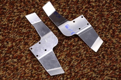

Now that the landing gear are finally installed, it was time to turn my attention to installing the wheel pant mounts, axles, brakes, wheels, and tires. I'm happy to report that the installation went pretty well, actually, and you have to admit that all of those machined parts look pretty cool.

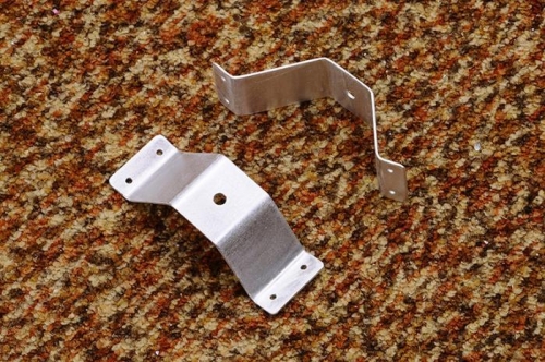

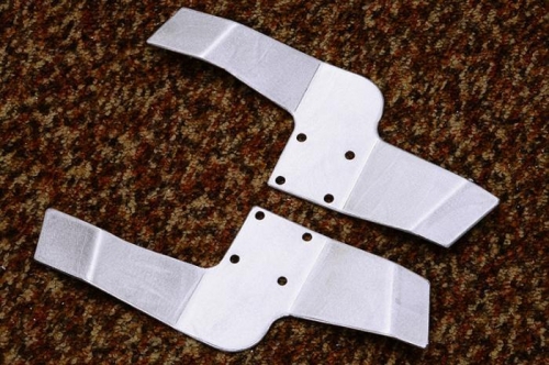

I started with the left and right wheel pant mounts. These are made of .125" 2024-T3 and are very accurately punched, drilled, and formed. Basically they only required taking a big file and rounding all of the edges off, then putting a light coat of primer on them. There were also the outside wheel pant mounts which are smaller and simply screw into the main wheel nut. Mostly just filing off the corners and then priming on these as well.

L&R Wheel Pant Mounts
L&R Wheel Pant Mounts - Ready For Prime
L&R Wheel Pant Mounts - Axle Nut Mounts
