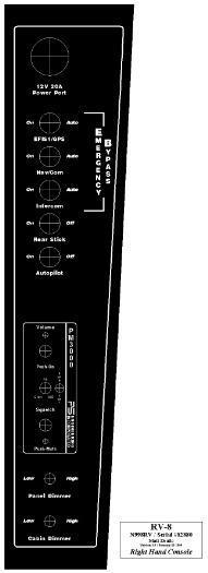

Well, like everything else, I agonized over the layout of the components of the right hand console. I started by drawing the outline of the top face in a CAD program, and then added exact scale representations of both the hole-cutout and the silk screen layouts. I'm pretty confident at this point on what devices are going in the right hand console, but I also wanted to add a bit of "extra" capacity, just in case I thought of something later on.
The components currently include:
* 12Volt/20Amp Power Port (Cigarette Lighter Adapter)
* Emergency Bypass Switches
- EFIS 1 / AHRS 1
- GPS
- Nav/Com
- Intercom / Headsets
* Disconnect for the switches on the rear stick grip
* Emergency disconnect for the Autopilot
* Stereo Intercom
* Dimmer control for Panel Lights
* Dimmer control for Cabin Lights
* Spare slot for additional Switch
After a fair amount of arranging and then rearranging and then rearranging again, I came up with a layout in which I was satisfied. There is an extra "location" for another switch right under the Autopilot switch.
CAD Layout Including Holes & Silk Screening

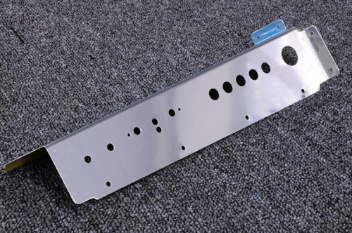

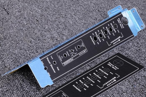

Holes Drilled Through Label Template
Removed Blue Vinyl & Label
