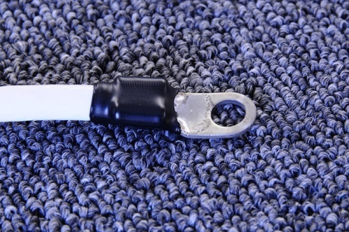

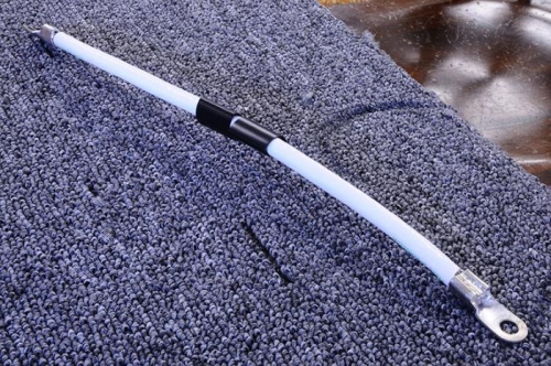

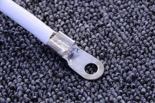

Brief Description:  #2 AWG Cable Fabrication - Part 1
I found a sweet tool on the B&C web site for terminating the huge #2 AWG power cable that interconnects the battery, GPU plug, and starter solenoid. I opted to also solder the lugs using a propane torch. Followed up with a bit of self-sealing heat shrink and they look like they were built in a factory!
#2 AWG Terminated & Soldered
#2 AWG Crimped & Soldered
#2 AWG Self-Sealing Heat Srink
