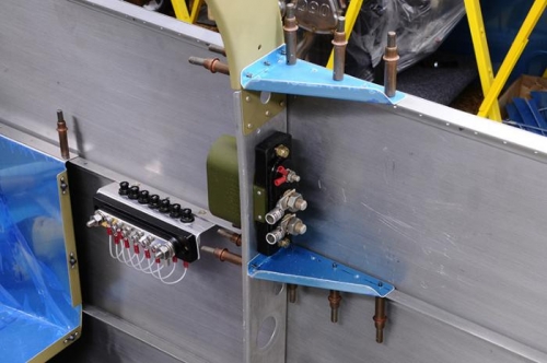

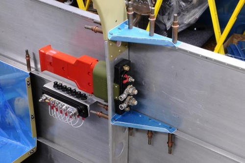

Brief Description:  GPU Plug Mount Reenforcements
After plugging and unplugging the GPU adapter in a few times, I was just feeling like there wasn't enough strength in the bulkhead mounting of the GPU plug. After a bit of staring at the installation, I came up with a couple of .032 braces that seemed to do the trick. The plug mounting is much more substantial now and I want to say will hold up better over time.
GPU Plug Mount Gussets
