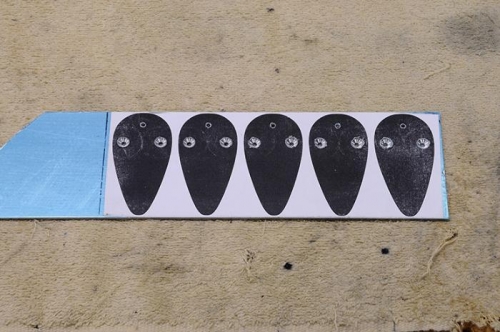

In my estimation, there isn't a clear recommendation in the plans on how to hold the long, cowling side pins in. They take a drill to actually get them all the way in, but they could definitely work themselves out with vibration, so some method of holding them in with a screw or something is necessary. The pins are about 3 feet long and join the upper and lower halves of the cowling together through a piano hinge. Its a pretty slick system, but can be a little frustrating at times trying to get them in and out. Van's offers replacement hinge pins with pre-welded "tabs" that are about 1" long and about 1/2" wide with a single hole for running a screw through and into a platenut mounted inside the cowling. While that would certainly be functional enough, it just lacks something in the elegance department.

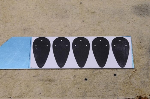

A couple of weeks ago, I happened to notice these little airfoil-shaped retainers on a fellow RV-7a builder's plane. I decided to try to make a set of my own. I started with a sheet of .063" 2024-T3 and the laid out the shape I had in mind in CAD on the computer and then printed it out on some adhesive backed paper. I added a center, front hole to allow the angle on the hinge pin to poke though and be held from going in or out. I then added a couple of #6 counter sunk holes for mounting the retainer to the cowling, and then added a couple of platenuts mounted on the inside of the cowling. I got the bend in the retainer by putting both the left and right piece together in the vice and gently "pounding" a series of small bends until I had a shape that matched the contour of the cowling perfectly. I used a belt-sander to get the final outside shape of the retainer, and then surfaced the top side to remove any of the bend marks.
All-in-all the whole thing came out pretty nice. The retainers hold the pins securely, and more or less look like they were suppose to be there.
Airfoiled Retainers Done On CAD

Holes Drilled, Screw Holes Counter Sunk
