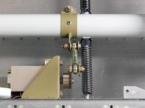

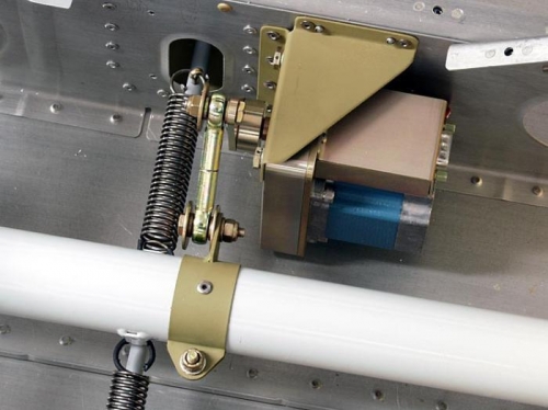

Brief Description:  Installed Autopilot Roll Servo - Part 1
Installation of the roll servo for the TruTrak autopilot was pretty straight forward. The system seems to work well and doesn't add any noticeable drag to the aileron stick forces. Fortunately, it just fit in with the Electric Aileron trim setup. I actually had to move the control horn on the stick column forward about 1/8" to assure that there wasn't any interference between the rod end bolt and the left spring. Seems two work fine and there is no binding or rubbing of any kind.
