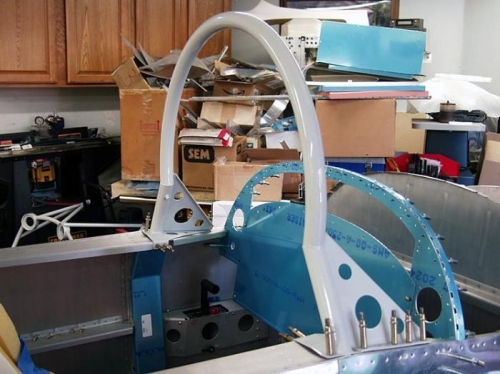

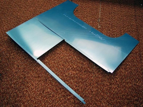

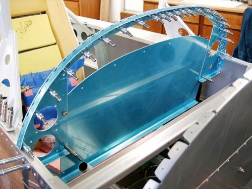

Wow, its starting to look like a real airplane all of a sudden! Built up the instrument panel, and installed the rollbar. Trimmed the forward turtledeck skin and fabbed up the two baggage area stiffeners and then cleco'd and matched drilled to the fuselage bulkheads. Wow, that went quick! On the RV-4, that skin was basically just a square piece of metal that had to be cut to fit, then marked and drilled and that fit was if-y at best. This one fits on perfectly and all the holes lined up exactly! Amazing!
Rollbar and Instrument Trial Fit
Instrument Panel
Instrument Panel
Forward Skin Cut With Stiffeners
