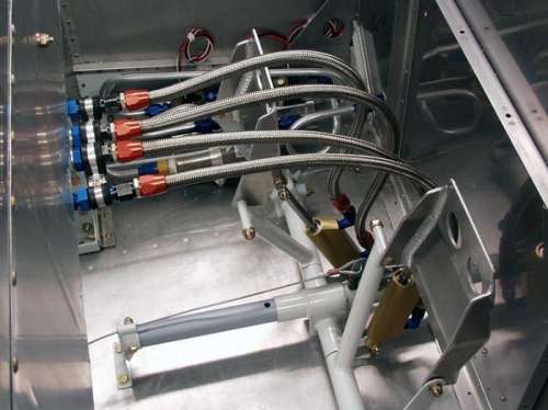

Brief Description:  High and Low Pressure Flex Lines Installed To Mast
I made all of the Flex line connections up to the high and low pressure fittings on the left and right brake master cylinders. The pictures show the full Left/Right/Center rudder pedal throws and the cables fit and flex perfectly. Pulling the rudder pedals back to the aft extreme for the "short pilot" still gives good hose movement with no binding or rubbing. Very nice!
Flex Hose To Master Cylinders - Pedals Centered

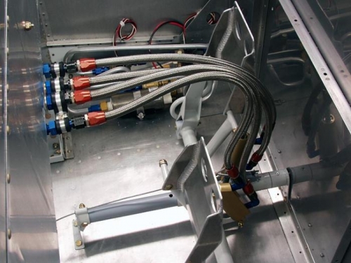

Flex Hose To Master Cylinders - Pedals Left
Flex Hose To Master Cylinders - Pedals Right
