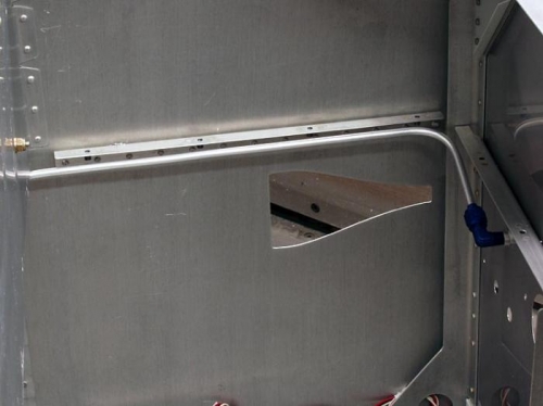

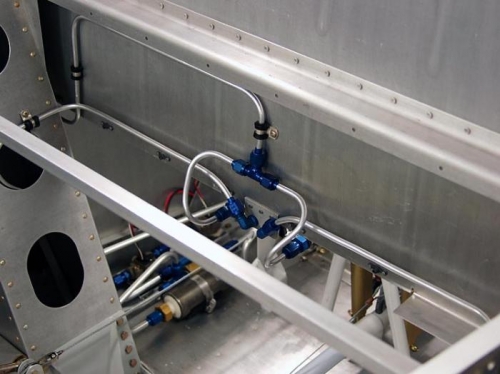

I decided to run a 1/4" hard line from the Brake Fluid Reservoir around onto the #2 bulkhead and, insert a Tee fitting, then run Stainless Steel flex lines down to the Master Cylinders on the low pressure side. Over all, the system came out very nice and looks pretty sharp.
Low Pressure Line From Brake Fluid Resevoir
Tee In Low Pressure Brake Fluid Line
