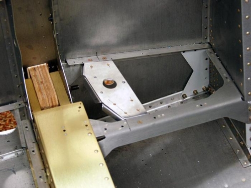

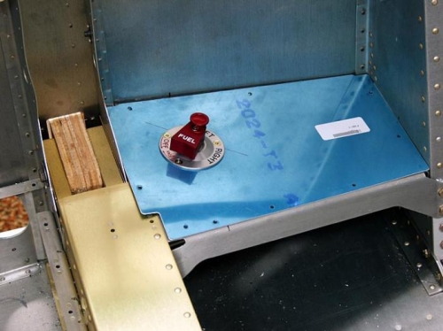

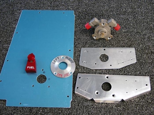

Brief Description:  Fabbed New Mount for Andair Fuel Valve
The stock mount for the fuel selector valve is too small for the aftermarket Andair FS20X7-T Van's also supplies. Fabbed new mounting bracket and mounted. Used same hole location as stock. Fuel ports are in slightly different location so I hope that doesn't become an issue down the road.
