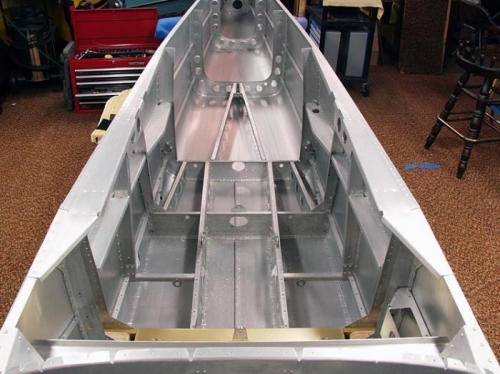

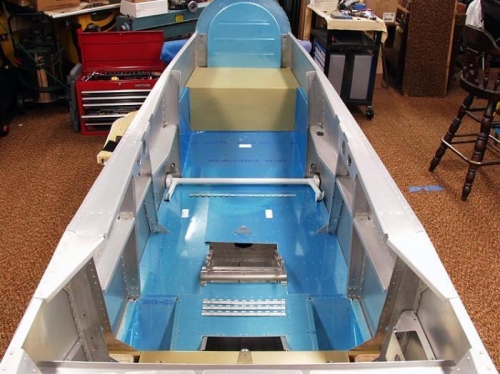

Date:  9-14-2008
Number of Hours:  20.00
Brief Description:  Aft Main Spar Floorboards
Fabricated and trial assembled all of the floorboard components for the areas aft of the main spar. Fabricated and installed the Flap weldment brackets. Installed platenuts in several places. Primed all of the undersides of all floorboards. Left topside bare for powder coating later. Screwed up and primed the wrong side of the baggage area rear skin... Crap.
Fuselage Matched Drilled
All Floorboards Match Drilled and Fabricated
Floorboards Test Fit
