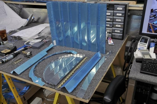

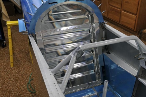

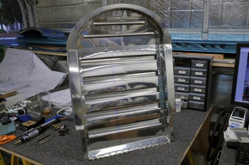

Brief Description:  Rear Seat Back Assembly - Part 1
The rear seat back structure went together pretty well. I only screwed up two 1/8" rivets driving with the rivet gun. Imagine how pissed I was! It took me all day to clean and debur all of the parts and in 35 milliseconds, disaster. I hate using the rivet gun. Fortunately, they really aren't too bad, most people wouldn't even notice frankly, and they are hidden by the seat back cushion. So shut up about it...
Rear Seat Back - Deburred and Drilled
Rear Seat Back - Riveted
Rear Seat Back - Installed
