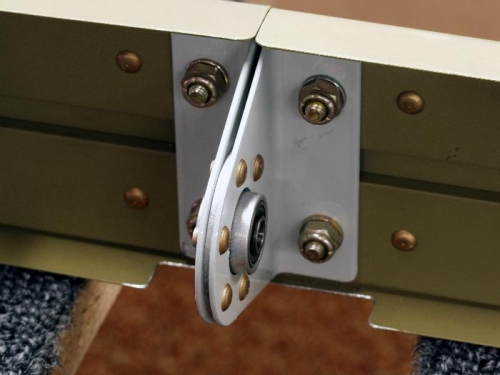

Brief Description:  Rebuilt New Horz Stab Center Hinge Mount
The first one was tweeked a little because of drilling. I ordered TWO of the pre-punched versions and a new bearing and it fit great. Yeah, I know the nuts are on the wrong side in the picture! I subsequently swapped them around the other way.
Replacement Center Hinge
