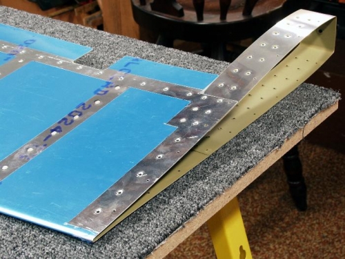

Brief Description:  Riveted Counterbalance Skin to Left Elevator
Wow, what a sweet trick. If you rivet the counterbalance skin to the main elevator skin before you start riveting the understructure, you don't have to use pop-rivets on the 4 inside holes. Now if there was such a trick for those last couple of rivets on the end of each rib... Sigh...
Counter Balance Riveting
