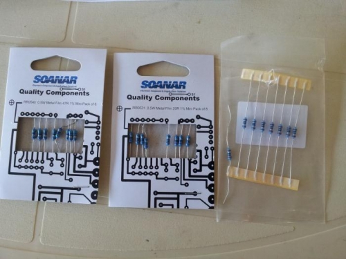

Ed bought some resistors so we could accurately test what the Skyview is looking for from a pressure sender unit - 20ohm showed 1.6psi and 47ohm showed 5.8psi - so I need a sender unit with a resistance range of say 10ohm to say 50ohm. Will contact VDO and see which is the closest uint.

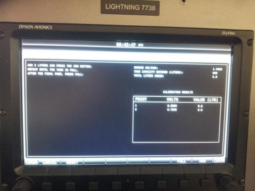

Then progressed to calbraiting fuel levels into the Skyview - again this involved emptying each tank and filling it in 5 ltr increments. Again it took 3 hours as I had to wait for each level reading to stabilise before entering it into the Sykview and progressing to the next level.
And yet again (!!) after the calibration was completed, the display would not show the fuel levels. So another emailo has gone off to Dynon seeking advice .....

Various resistors.
Various resistors.
Calibrating the Skyview.
