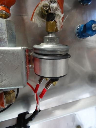

Been getting low fuel pressure readings on the Dynon - around 2.2psi with the electric boost pump on when it should be closer to 4psi. And WOT sees the pressure reading drop to zero. So again with Peter T's help I made up an adaptor to connect his pressure meter to the end of the fuel line that normally attaches to the fuel pressure sender unit. Surprise, surprise - Peter's meter reads the pressure exactly as it should be ..... Fiddled with the connections on the pressure sender but the low readings remained constant. Next step, buy a replacement pressure sender unit and see if I can't get accurate readings to display on the Dynon.

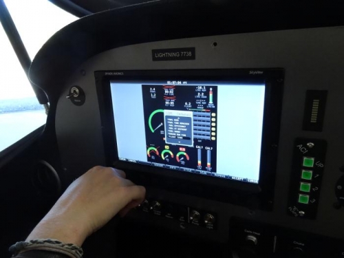

My manual has very poor instructions on calibrating the fuel level sender units - but Peter's D180 manual (also from Dynon) has very clear instructions. So Robert and I read them and are now ready to stage fill each tank (in 5 ltr increments) and calibrate the fuel level units. Then we will have fuel level readings on the Dynon. Have to use the correct fuel as the level sensors work on resistence in the fuel, and different fuels have different dielectric constants (learnt that one today from Peter's manual!).
Fine-tuning the EMS display.

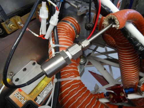

With enough bits you can connect anything ....
Fuel pressure sender unit.
