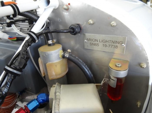

Step 4 - do something simple like riveting on the SS ID plate so something was achived today!
