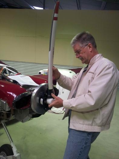

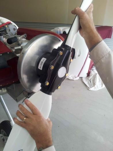

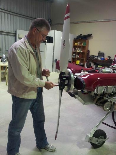

Finishing the fitting of the prop. I set the pitch using the markings on the centres white hub as per the instructions - thought I have been warned to use a proper protractor to check that both blades are pitched exactly the same. I'll do this after firing up the engine and checking what revs I can get from the current pitch setting.

Reading the scale on the centre white hub and twisting the blades to about the right pitch ...
Tensioning the bolts retaining the front of the hub and the blades - carefully!
