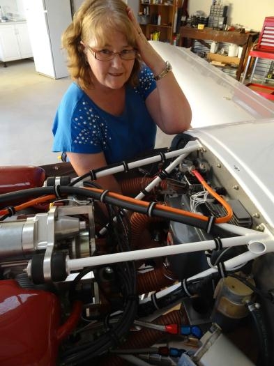

Drained the small amount of fuel remaining in the tanks - it is a few wekks old now so somewhat stale. Used the electric boost furl pump to pump out the tanks.

Sheryl helping with draining the fuel - yet again!
