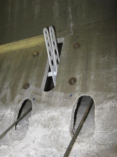

Made up the support brackets and fitted and filed the bushes flush - then assembled the bell crank assembly. Then made the fitting template (jig) as per the manual. Drilled the mounting holes in the seat back (using the template) and trial mounted the assembly. All fitted well. Removed the assembly and stored for final fit later.

Installed assembly
Installed assembly
