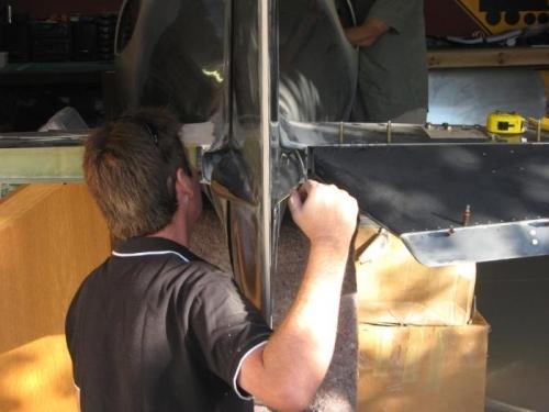

Tight fit down the back of the fuse ....
Dean helping pull through rudder cables.
