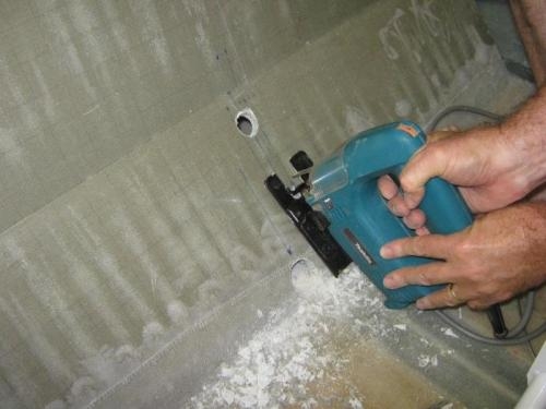

Measured to locate the centreline on the floor - then marked up for the rudder cables holes and the elevator bell crank hole. Cut the holes and smoothed them."

Cutting rudder cable holes and elevator bell-crank hole through seat back
