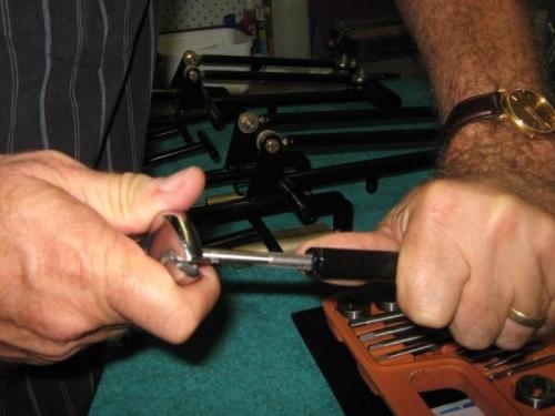

Some unexpected prep work with the pedal assemblies. The powder-coating filled the threads of the contained nuts in either end of the connecting tube - had to clean the threads out with the tap.

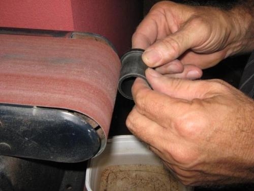

Then found that the spacers wouldn't fit inside the assembly tops - powder coating again. Sanded out the inside of the tubes but still needed to sand down the spacers to fit.

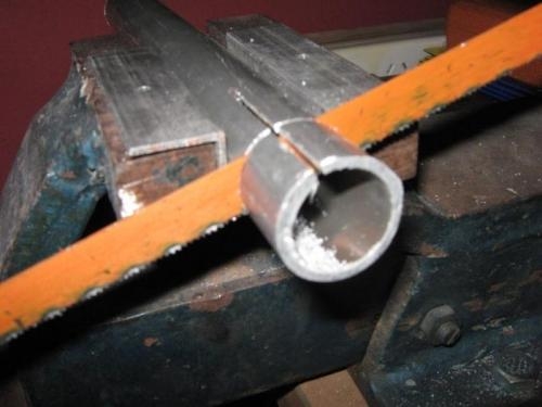

Made the stops from the left over 1"" tube - as per the manual."
Tapping powder coating from nut in connecting rod
Grinding down the pedal tube end plug
Making the pedal tube end stops.
