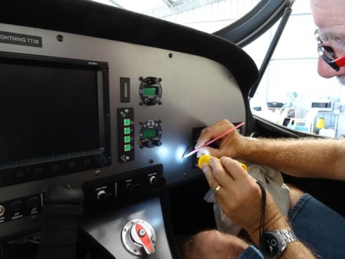

Continued general detail work - made and applied the required fuel tank labels, touched up the panel paint, checked complianace with the Jabiru engine servicve bulletins (all done except the fitting the new through bolts and nuts).

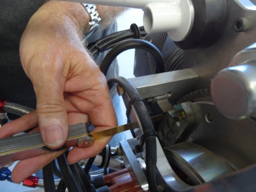

Had to buy brass feeler gauges to check the mag gap (bit hard to use steel gauges against a magnet ...). The gaps appear to be 10 thou to 12 thou so it should be fine (speci is 10 thou).

Painting out panel scratches
Checking the mag gap with the new brass feeler gauges.
