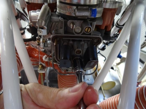

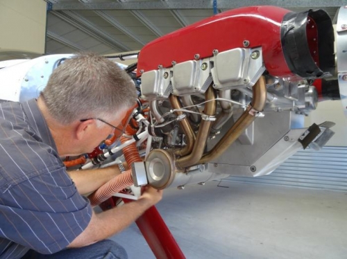

The first engine start up produced an idle only (engine stopped as soon as the throttle was opened or the choke reduced) - so today I pulled the main jet and needle seat to check for a blockage - none found. The 2 floats were not quite even so I levelled them and made sure they were operating bowl fuel valve properly. Next step is to restart the engine and see if the fuel delivery problem has been fixed.
