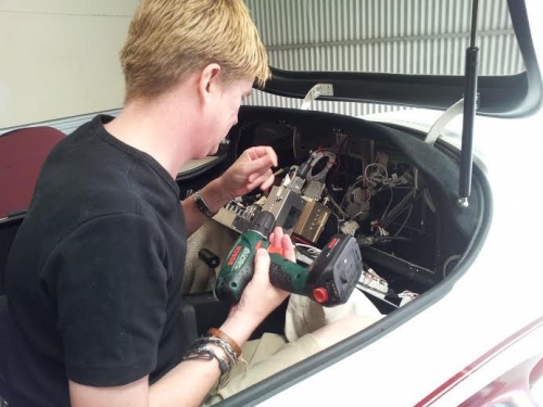

Niggly work - one of the nut plates worked loose behind the panel so Robert drilled it out and fitted a new one. Would be better to get the plane flying before doing too much more general repair work!
Robert replacing one of the panel nut plates.
