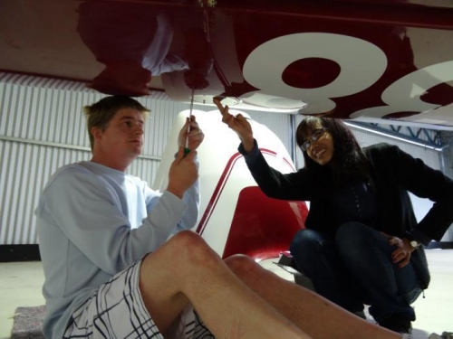

Had Robert & Thon work with me today - getting lots of small finishing work done. Robert checked all the control surface lock nuts, marked them with nail polish so we can see if they move - then fitted all the clear perspex inspection hole covers (so we can inspect whout removing the covers.

Fittinf all the clear inspection covers.
