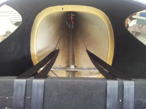

Centre belts bolted in.
Shoulder belts fitted.
