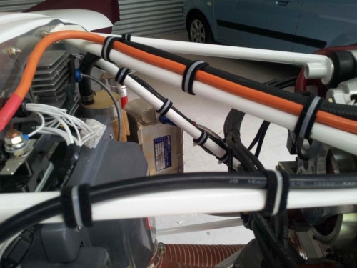

Spent a few hours removing all the temp cable ties, rerouting some of the leads etc, and using velcro strap and cable ties to tidy everything.
Cut out and fitted the wind step patches - and the No Step signs for the flaps.
Had great trouble fitting the last of the fire sleeve. Had to buy a new roll and this roll seemed smaller and tighter. Tried CRC, tried baby powder, but in the end Laurie suggested shoving compressed air in one end. That expanded the sleeve straight away and on it went ..... New trick for the day.
Tidied leads and cables.
