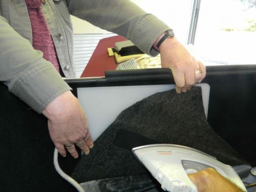

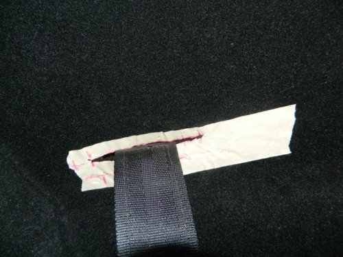

The cockpit sides are lined with lightweight backless carpet. Slots needed to be cut to allow the seatbelts to pass though. The fabric of the carpet is not that strong, so I ironed clothing repair cloth tape to the back of the carpet to reinforce around the slot. Worked fine....
Adjusting the slot cut through the liner.
Ironing reinforcing cloth to the back of the liner.

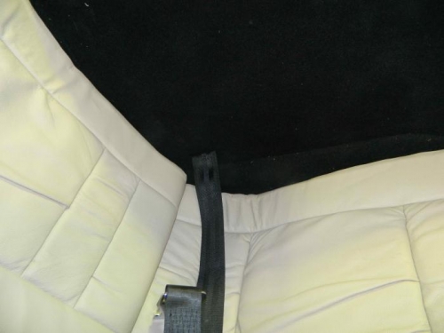

Finished.
Finished.
