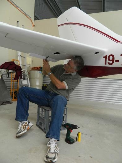

Adjusting the centred position of the elevator trim.

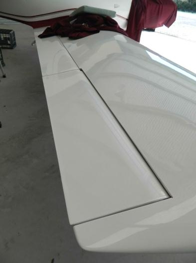

Flap aligned.
Flap aligned.

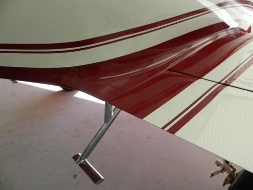

Ailerons aligned.
Ailerons aligned.
