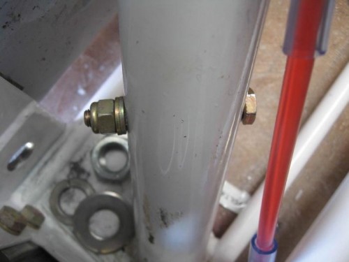

The gear leg retaining bolts did not have the required 2 threads clear of the nyloc nuts - ie too short. Had to order longer bolts from the States - then take the weight off the gear by propping up the wings, knock the old bolts out and fit the new bolts.

New bolts in place.
New bolts in place.
