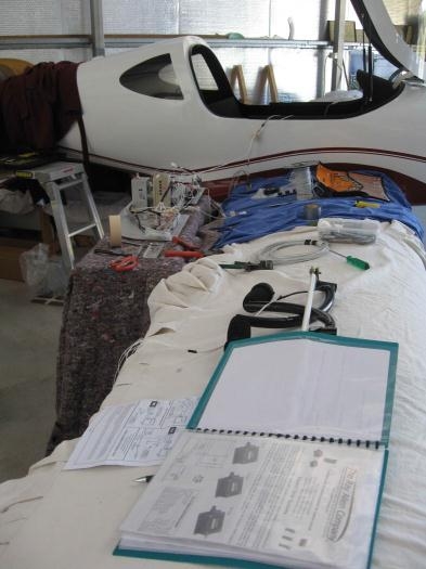

Brief Description:  Control sticks & evevator trim electrics.
Finished wiring the landing lights. Fitted the new master relay and rewired it right through to the panel - fired up the panel for the first time and the landing lights, booster fuel pump and elevator position indicator al worked properly.
Discovered that some of the labels on the stick wires had fallen off! Spend and hour with Peter T running continuity checks to relabel the wires. Designed the circuit using the relay board. Decided to locate the relay board on the small bulkhead behind the panel. Wired up all the leads from the control sticks - and wired up the leads to and from the relay panel. Slow but important work so good progress made.
New loooong workbench.
