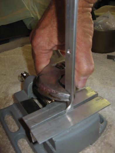

Brief Description:  Mounting bars to hold cables in position
The cables need to held somehow between the dash and firewall. The distance is about 700mm and if they are not held they will droop and be visible, and they could foul the rudder cables. So I have made 2 drop down bars to bolt to the stiffener section behind the panel. 2 bolts hold them to the panel. The bottom end has a hole drilled through and is twisted 90 degrees. I can now simply cable tie the control cables to the end of these bars to hold them exactly where I want them.
Twisting the bar.
Twisting the bar.
