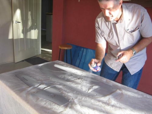

Painting the face plates for the dash and consoles
First test paint was too dark - so back to get the next lighter metalic silver paint.
Sanded with 400 paper then washed with prepsol and dried. Grey undercoat/primer, then top coat. Used automotive aerosol spray packs.
Spray painting .....
