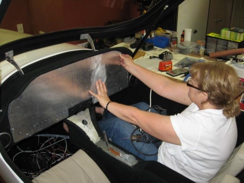

Brief Description:  Fitting nut-plates to secure the panel.
Held the panel in position and drilled through to locate the nut-plate holes. Then fitted and tested all the nut-plates around the panel. Fiddly but not hard ..........
Sheryl helping to hold the panel in position.

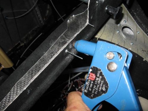

After drilling through the holes in the panel - drilling for the nut-plate rivits.
Riviting the nut-plates into place.
