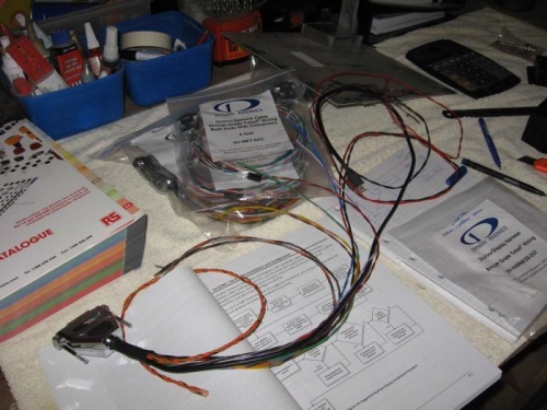

Studied the Dynon Skyview manual to work out the basic configuration and connections. The packs don't give the length of the cables so opened every pack and measured the cable lengths. Read all the separation advices but I can't get everything 1m away from everything else so had settle for some compromises (radio antenna, 1m from transponder antenna, 1m from GPS receiver - all a min of 1m from the pilot ......................
Chatted to Peter T and satified myself that i can extend all cales as need be - so I can locate the remote units where I want them (under the rear parcel shelf)

Working out the configuration and measuring the length of cables.

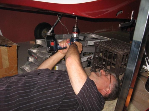

Drilling the holes for the transponder antenna and outside air temp sensor.

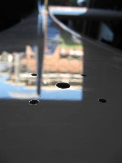

Holes for the GPS receiver on the top of the fuse.
