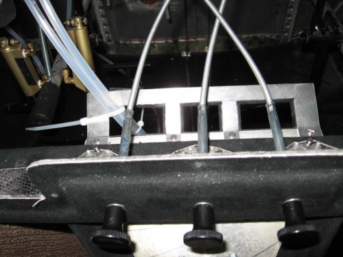

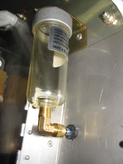

Fitted the bracket mod to try to hold/locate pipes and cables as they pass from under the centre console up to the behind panel area. Drilled the firewall holes and routed the (from left to right) carbi heat, choke and cabin heat cables. Moved the rudder pedals full backward & forward to determine the path and length of the brake line to the reservior on the engine side of the firewall. Drilled a 1/2" hole and protected the brake line with 1' length of rubber fuel line. Fitted the brake line to the reservior and fitted the reservior. Started routing the brake lines to the master cylinders - pessed them through holes at the top of the half bulkhead.
Ist go cable routing.
Bracket to guide/hold pipes & leads.

Brake reservior.
