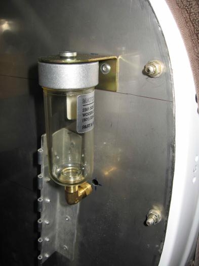

No instructions for the brake fluid bottle. Logic says it should the highest point in the system if possible - so I fitted it to the top LHS of the firewall.

Brake fluid bottle.
Brake fluid bottle.
