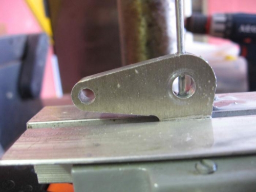

Good constructive "bitza" day - got lots of small things done. The air box rocker is not well aligned - it goes over cam well one way, but only just over the other way - so likely to fall shut. It also required a very tight pull on the cable to get the move started. Worked with Rodney and drilled a new hole for the locating pin so I could rotate the actuating bar 45 degrees. Simple change and now the cable pulls much more cleanly.
Fitted the throttle linkage extension arm supplied with the kit - then drilled the new hole required in the throttle cable holding arm.

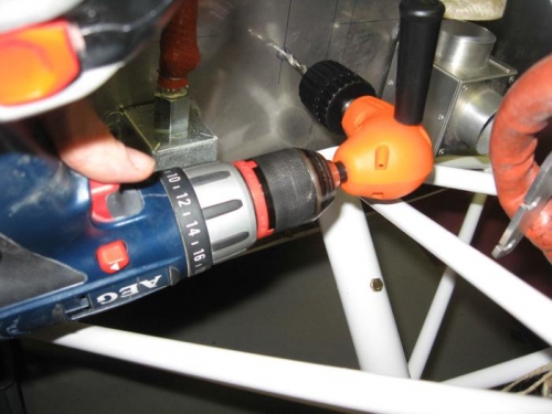

Bought a right angle drill to do some cable hole drilling thorugh the firewall.

Making the new hole for the Carbi cable.
Using the right angle drill.
