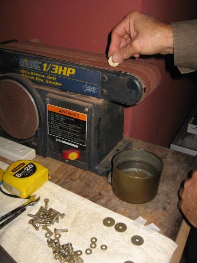

Checked all the firewall bolts for length - changed out most of them as they were too short for the lock-nuts. The large area washers were not fitting flat against the firewall flange - they were binding against the inside of the fuse as the holes are too close to the outside of the firewall flange.
Ground a flat on all 17 washers to make sure of a good fit.
Grinding a flat on the large area washers

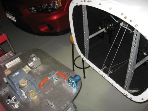

The firewall holes/bolts near the outside edge
All ready for the firewall to go on.
