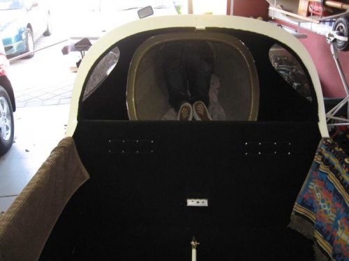

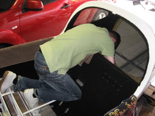

Brief Description:  Fitting the elevator trim cable
Robert and Thon helped fit the elevator trim cable. Had to remove the elevator push rod to get acess, then Robert climbed right in to drill through the rear firewall and fit a rubber grommet. Then Thon - with her very slender arm! - was able to feed the cable through the grommet so Robert could pull it forward. Drilled another hole in the bottom of the rib at the back of the baggage compartment and fitted another grommet - then pulled the cable through that.

Robert drilling through the rear bulkhead
Thon feeding the trim cable through the rear firewall
