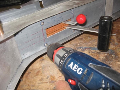

Brief Description:  Centre console - final prep for upholsterer.
Removed the quadrant throttle and changed the knob tension adjuster with an extension tube and nylock nut. Cut an access hole through the side of the console to take a socket to turn the nut and adjust the tension.
Removed clecoes and riveted the top extension on.
Changed the cup head screws with counersunk screws so the cover plate can sit flush.
Filled and sanded smooth the extra holes now that the design is set.
Console is now ready for upholstering.

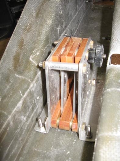

Quadrant throttle inside the console.
Top of the quadrant.
